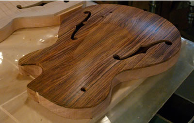

Paul, I think I understand your bracing scheme now. Why 3/4" x 3/4" -- seems kinda large?
Is the top carved spruce?

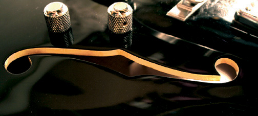

Binding "f" holes with flamed maple is real fun. I've got two in the white right now that I CA'd in maple. On one I stuck my hand to the back of the plate....ouch!

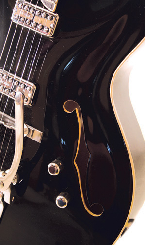

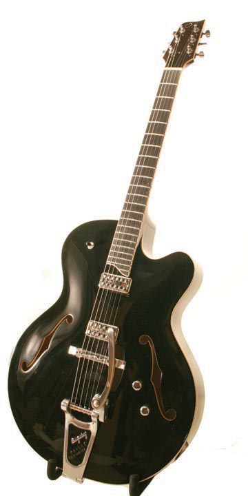

I can't get pics that I'm happy with. Nothing like trying to shoot gloss black. May as well try to photograph a mirror.
Carlton: You've seen one other one, the mahogany topped LG. In about a week I'll post all of them together.
the paint is catalyzed poly urathane. Yes, clear over the black. Tony did the finish. Scale is 25.5 and neck is 1.75 to 2.125.
Anthony. Yes, the struts are big but I really wanted to make sure I didn't miss them when I routed the cavities. Now that I know where everything will go, I'll be able to use just small tabs to hold the screws. Yes, carved top and back.

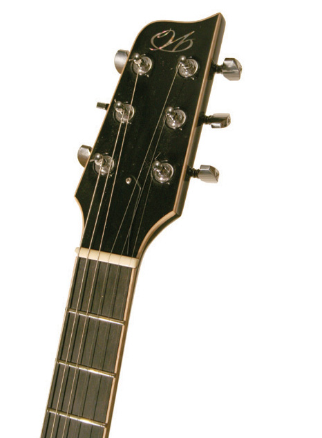

Whew, Photographing gloss black is a tough job. I didn't do the best job but you get the idea.
Pics as requested. P

I realy like your headstock shape and nice looking F-holes. Very Cool Guitar Paul .
PostPosted: Thu Jun 22, 2006 8:41 am
Hey, I'm glad you gave us the headstock shot! Looks like you did a countersink for the gear washers--Nice! Your "W" is classy, too. I've been having a difficult time trying to visualize an "M" that hasn't been done before...hmmm...if I flip over your "W"....
